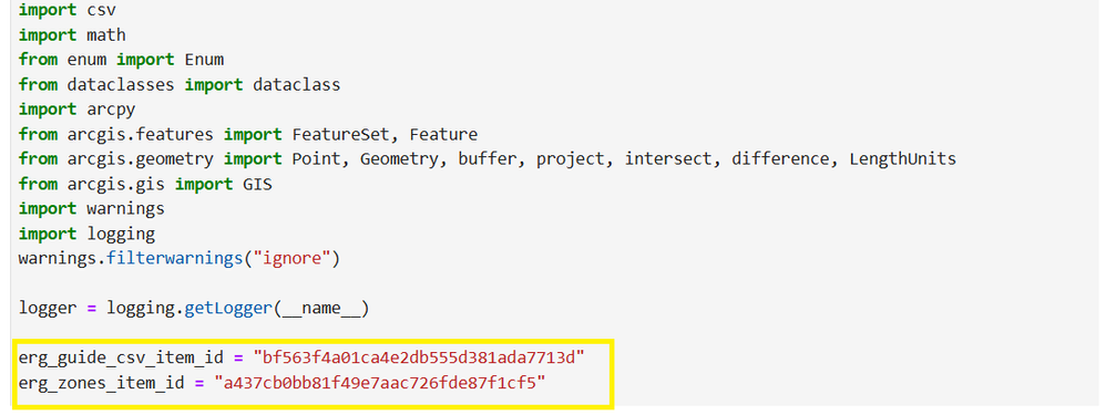

  7. Replace the quoted item IDs with the item IDs of the ERG Materials CSV and ERG Zones feature layer in your organization.
    8. Click Save to apply the changes.

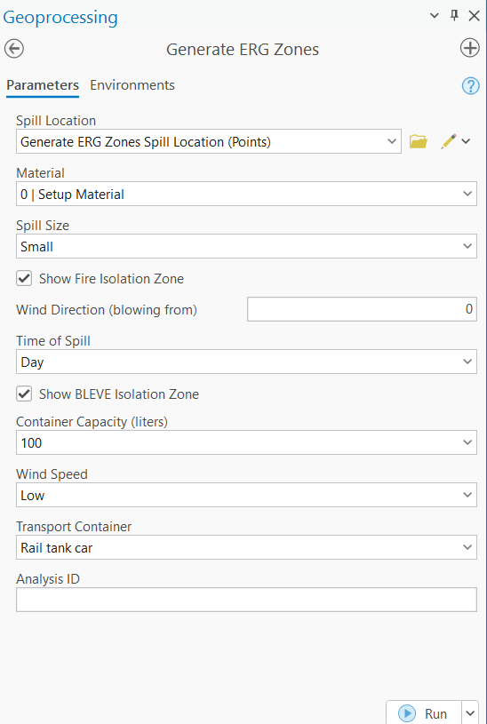

Run the tool in ArcGIS Pro
Before publishing, run the tool once in ArcGIS Pro using the Setup Material option to ensure all ERG zone types are included in the published service. The Setup Material option is available at the bottom of the Material dropdown.
  1. Open the Generate ERG Zones tool.
  2. Use the pencil icon to draw a single feature on the map.
  3. Select 0 | Setup Material
  4. Enable the Show Fire Isolation Zone parameter.
  5. Enable the Show BLEVE Isolation Zone parameter.
  6. Click Run.

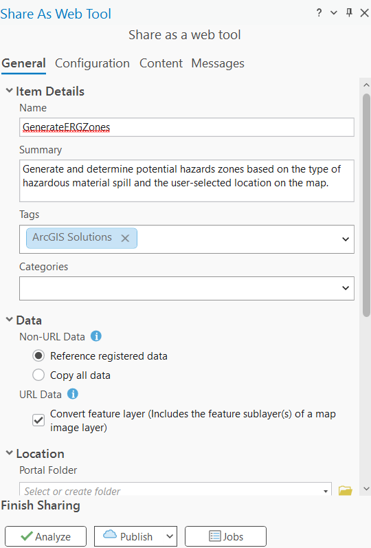

Publish as a web tool
  1. Sign in to ArcGIS Enterprise.
  2. From the ribbon click Share > Web Tool and select Share Web Tool.
  3. From the Select Tool To Share dialog select the tool run from the previous steps and click OK.
  4. In the Share As Web Tool pane fill in the item details.

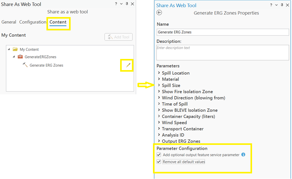

  5. Go to Content > click Edit button on the tool > select:
    •  Remove all default values.
    •  Add optional feature service parameter.
  6. Click Publish.

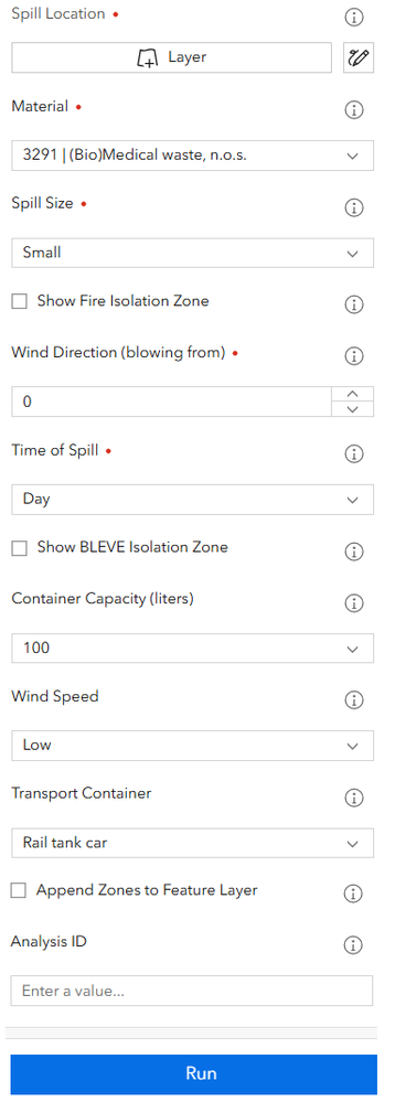

  1. The spill location can be added in several ways (see image below):
    • Add a layer: Click Layer to add a layer from the organization.
    • Draw on the map: Use the Sketch tool to draw it directly on the map.
    • Use an existing feature: Click the point feature on the web map to open its pop-up. Select Actions > Set as Analysis Input, then complete the dialog to choose the tool and set parameters.
  2. For Material, choose a material by searching by name or placard number, or by selecting it from the drop-down list.
  3. For Spill Size, choose Small or Large.
    Note: The Emergency Response Guidebook defines the threshold between a ‘Small and Large’ spill size as 55 gallons (208 liters) for liquids, and 60 pounds (27 kilograms) for solids.
  4. Optionally, enable Show Fire Isolation Zone to create a Fire Isolation Zone.
  5. For Wind Direction (blowing from), provide the wind direction in degrees.
  6. For Time of Spill, choose Day or Night.
    Note: The Initial Isolation Zone, Protective Action Zone, and Downwind Zone are generated using the distances specified in Table 1 of the ERG Guide, based on the selected material, time of spill, spill size, and wind direction.
  7. Optionally, enable the Show BLEVE Isolation Zone parameter to create a BLEVE Isolation Zone.
    This zone will only be created if it is applicable to the selected material. The size of the BLEVE Isolation Zone will correspond with the chosen container capacity. In the CSV file, applicable materials have a BLEVE column value of “Yes.”
    If applicable to the selected material, specify the Wind Speed and Transport Container parameters. These parameters apply only to materials listed in Table 3 of the ERG Guide and are used to determine the size of the Protective Action Zone. In the CSV file, these materials have a Table 3 column value of “Yes.”
  8. Optionally, enable the Append Zones to Feature Layer parameter to append the results to the ERG Zones feature layer.
    Note: This parameter is only available in ArcGIS Online.
  9. Optionally, provide an ID in the Analysis ID parameter to help identify this run of the analysis. This ID will be written in the Analysis ID field in the output ERG Zones for reference.
  10. Optionally, provide a unique name in the Output Feature Service Name parameter to create a new feature service with the results of the analysis.
    Note: This parameter is only available in ArcGIS Enterprise.
  11. Click Run.

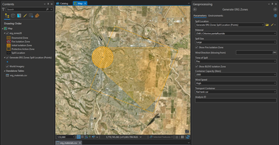

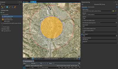

Review results
  1. Click the feature generated by the analysis to view its pop-up details.
  2. Click the History tab in the Analysis widget to view the recently executed results.
  3. Click the ellipsis (…) next to a result to access additional details and information.
  4. Under Result, click the Actions button, and then in the Export to item dialog box, click Export.
