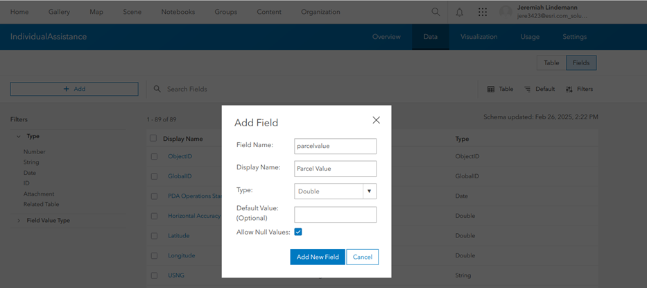

First you need to add a new field to the IndividualAssistance layer which will store the parcel value.  Repeat this step for other fields you would like to add.
  1. Sign in to your ArcGIS organization, browse to and open the IndividualAssistance layer.
  2. Click the Data tab.
  3. Click Fields.
  4. Click +Add.
  5. Add a field name of parcelvalue of type Double
    Note if your parcel values contain special characters you may need to add of type String and may not be able to do further calculations.
  6. Click Add New Field.

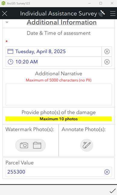

  7. Open Survey123 and verify at the bottom of the survey you see the values after you define a location.
Consider relocating the parcel value question within your survey, or alternatively, modifying its type to hidden so that it is not visible in the survey form.  Additionally, you can add new fields perform calculations to perform damage loss estimates based upon the damage severity in the previous questions.
