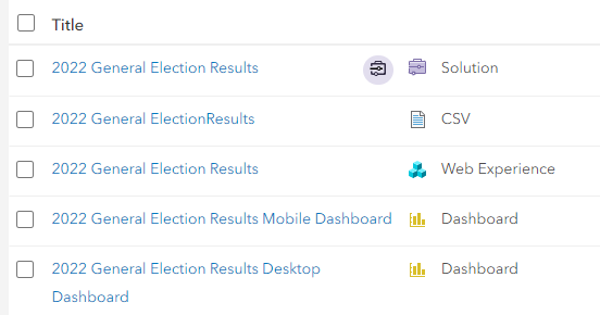

To assist with this we have created a new geoprocessing tool for ArcGIS Pro that can add a prefix or suffix to all the items and groups included with a solution deployment. So for example, if we deployed Election Results for the 2020 general election we could add the prefix '2020 General' to all the items included with that deployment. If we then deploy Election Results for the 2022 midterm we could add the prefix '2022 Midterm' to all items in this deployment. Now when we search for an item we can more easily distinguish between items associated with different deployments of the same solution.

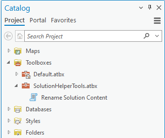

  3. From the Insert tab click Toolbox > Add Toolbox and add the SolutionHelperTools.atbx

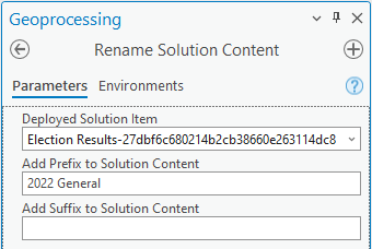

  4. Expand Toolboxes in the Catalog pane and open the Rename Solution Content tool in the SolutionHelperTools toolbox.
  5. In the Deployed Solution Item parameter selection the solution associated with the items you want to add a prefix or suffix to. You can also copy/paste the item id from the browser into the parameter.
  6. Add either a prefix or suffix you want to add to the item name.
  7. Click Run.
