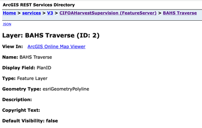

As you can see the BAHS Traverse layer's isVisible = true, but in the service directory the default visibility for the layer is false:
Screen Shot 2021-07-28 at 8.50.06 am.pngScreen Shot 2021-07-28 at 8.50.06 am.png
We are expecting this layer on map has a false isVisible but it is true. As mentioned before, this works as expected with SDK 10.2.5  for the same feature service.
