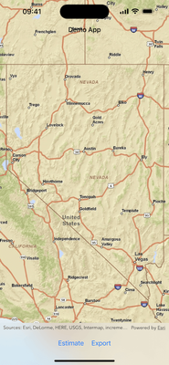

For example, below is the extent I tried to export.
Tile count:  321, File size:  7.1 MB
progress.fractionCompleted output: 0.01, 0.02, 0.03, 0.04, 0.06, 0.07, 0.09, 0.11, 0.12, 0.17, 0.27, 0.39, 0.6, 0.8, 1.0

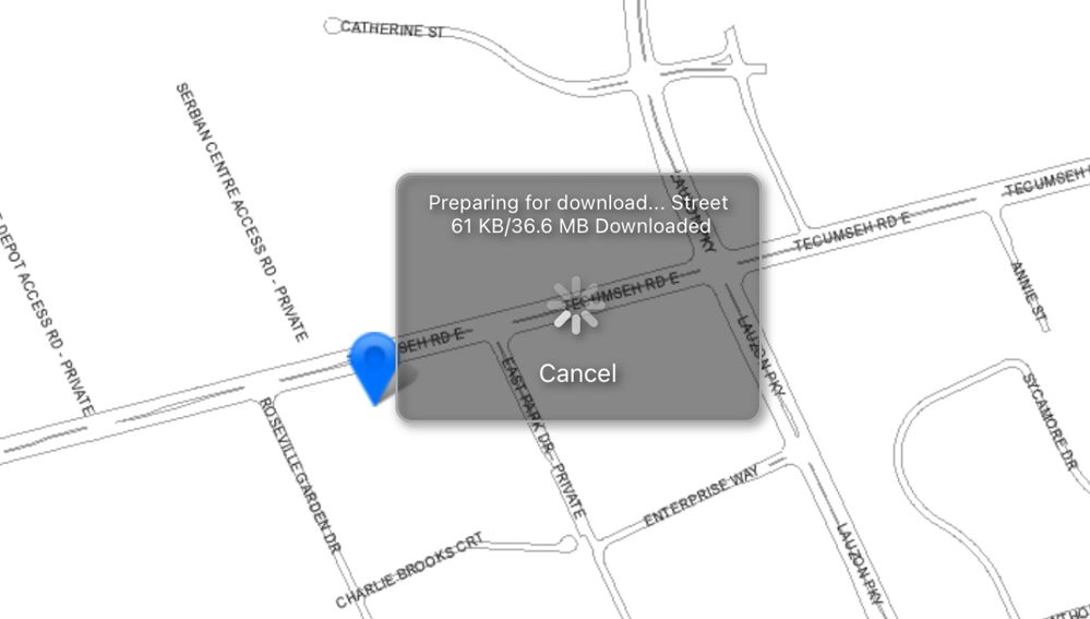

It's working now. but its not getting changed frequently as it should(please see attached screenshot). Any idea how can i get hold off the status for longer time?

Ting
by Esri Regular Contributor
Can you elaborate on what you means? Did you intend to upload a GIF?
Do you mean you want more frequent progress value updates, or want to show the status/progress spinner for a longer period of time?
AjiteshUpadhyaya
I mean, to show the more frequent progress value updates.
On the progress bar, i'm showing 61KB/36.6 MB downloaded(as per above screenshot). When it downloads more data to the device the value of 61KB should get changed and should show the updated values..
Any idea how to achieve this? Is it possible?
Ting
Thanks for the details. Upon my tests, the progress does jump from 11% to 89% without any fraction values in between. We'll see if it is a known issue or not.
