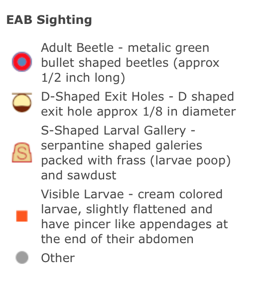

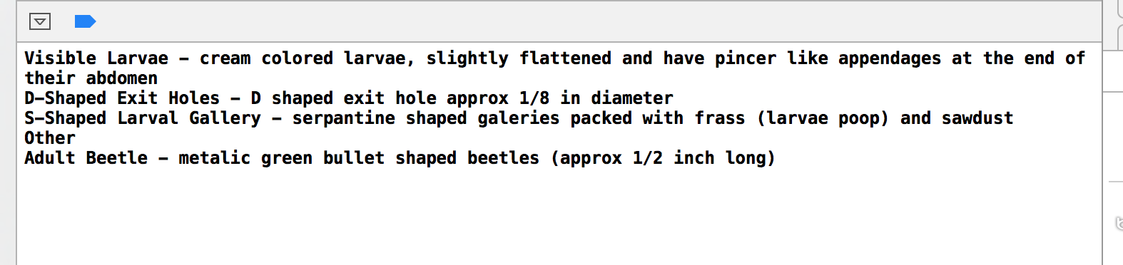

It seems like the templates are being added to the template picker correctly because my print statement shows the template names:

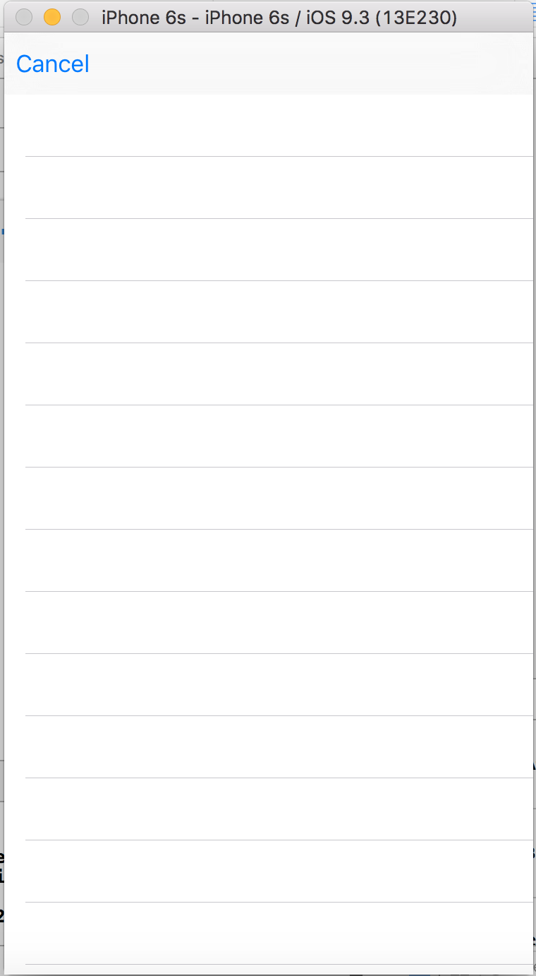

This matches the legend of the Webmap I'm using (left image below).  I cannot figure out what is going on.  When I present the template picker view controller it is a blank table.  I have added an outlet to the UITable as well (right image below):
Has anyone else ran into this issue?  I cannot figure out what I'm doing wrong.

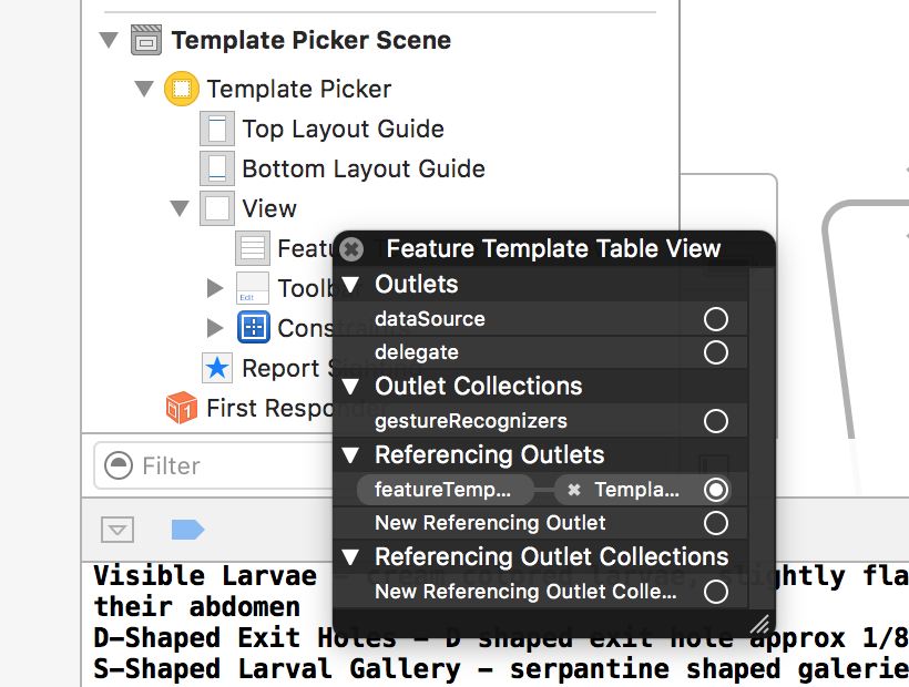

Can you check what is the state at this line and this​? Are the 5 templates getting appended fine?
You mentioned you have added an outlet to the table. How about the datasource and delegate? Are these methods getting called successfully?

Ah, thank you!  I had set the referencing outlet but forgot to set the outlets for the dataSource and delegate, no wonder it didn't work!  Once I did that my templates showed up!  In case anyone else forgets this crucial step, here it is:
