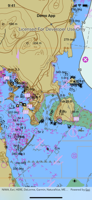

Hi,
Please take a look at the attached example app - I created it based on the Add ENC exchange set sample from iOS Sample Viewer. Plug in your API key and you should be able to see a screen like this 👇
Please refer to the sample for more details.
