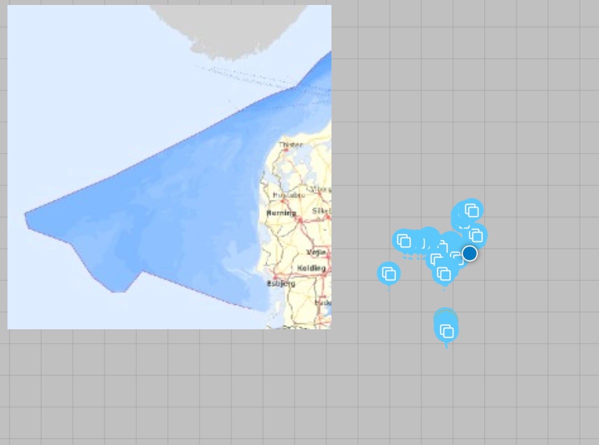

I have a map implementation that has been working great for a while now. However, my data provider is migrating to a new platform and I need to update the WMTS urls to stay in operation. The new WMTS urls doesn't match 1 to 1 on metadata and my map fails to load properly. I'm sure it's a configuration issue and that I just need to provide the correct parameters to ArcGis to make it work.
I have uploaded the old and the new WMTS files here, for reference:
Old service: https://www.dropbox.com/s/poafsecgr4u8zm0/oldservice.xml?dl=0
New service: https://www.dropbox.com/s/vtkset7s0s1ot46/newservice.xml?dl=0
When replacing the old service with the new, the map only loads partially and in really low resolution (it doesn't get better when zooming in). See example:
I am kind of clueless here, but have a vague idea that it might be the spatial reference that is off. I have been using an `AGSSpatialReference` with `wkid` 25832 for the old service. Not sure if it needs to change to something else.
There are no errors logged by ArcGis.
Does anyone have an idea what goes wrong here?

Good news!  We identified the problem and improved compatibility in ArcGIS Runtime version 100.14.0, released last week.
This behavior was triggered when Runtime could not match the ID specified by TileMatrixSetLimits/TileMatrixLimits/TileMatrix to a tile matrix ID specified by TileMatrixSet/TileMatrix/ows:Identifier.  For example, in this particular service TileMatrixLimits references View1:0 but TileMatrix identifier is just 0.
Older versions of Runtime incorrectly defaulted to a limit of "between 0,0 and 0,0".  But starting with version 100.14.0, the entire TileMatrix remains usable even when there is a problem with associated TileMatrixLimits.
So, this service now works in Runtime!
