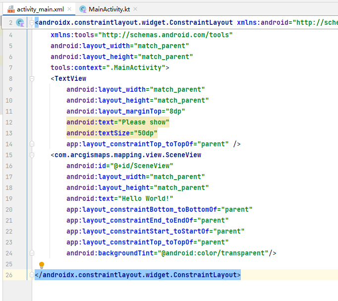

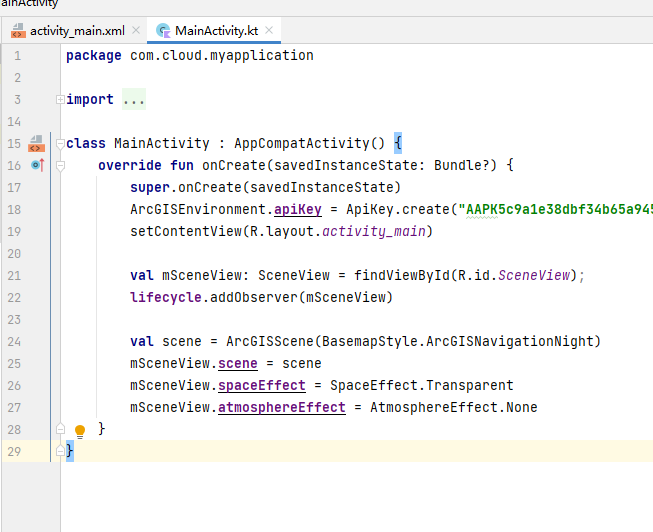

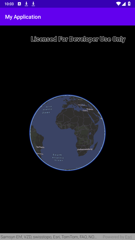

LinWenjian
help me god! I have the same question,how edit code about java file
