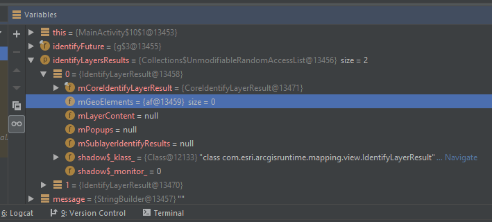

Hello! There was a problem with the identification of objects. mGeoElements equal to zero. what is the reason? how can I fix it? I can't get attributes because of this. ArcGIS Runtime SDK for Android 100.4.1

Hi Alexander, please check the following:
- You seem to get two IdentifyLayerResult instances back. Have you checked that neither of them contains any results?
- Try to increase the search tolerance, i.e. instead of 5 dp pass 30 dp for example.
- If none of this helps, please provide more information of the data in your scene. What layer types are in your scene? Would you be able to share your scene with us?
Gunther
