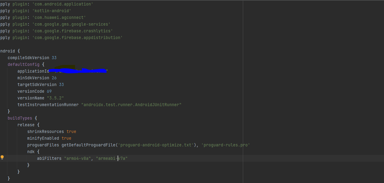

Hello there, after following all the possible given solutions , unable to reduce the APK size.
1.there are no BIG size image, redundant code, unused libraries.
2.appropriated ndk implementation is already done. code is clean with all related optimization.

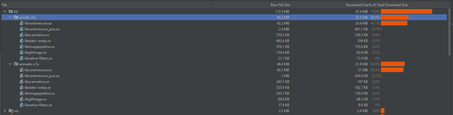

APK analyzer showing following images

Your apk still seems to have both `arm64-v8a`  and `armeabi-v7a`. You can further configure to split your apk's as suggested here and work on publish of multiple apks as recommended here
Thanks
Rama
