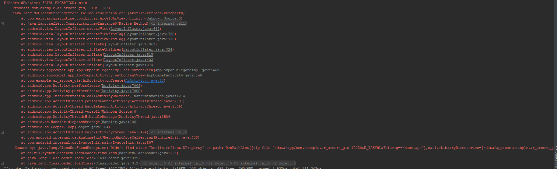

Hi!
An error occurs from the example

LukeDuncan1
Can you provide me with the device you are using and what version of Android it is running?
I tapped the button and received a different error related to a layout inflation when running on OnePlus 7 Pro running Android 10.
Please check that this section in activity_ar.xml is fixed:
<include
    layout="@layout/layout_calibration_controls"
    app:layout_constraintBottom_toTopOf="@+id/calibrateButton"
    app:layout_constraintStart_toStartOf="parent"
    app:layout_constraintEnd_toEndOf="parent"
    android:visibility="gone"/>
Note the @layout added to the layout tag.
Thanks,
Luke
AlexanderKulikov
Thanks Luke!
Replaced with this markup and everything worked!
