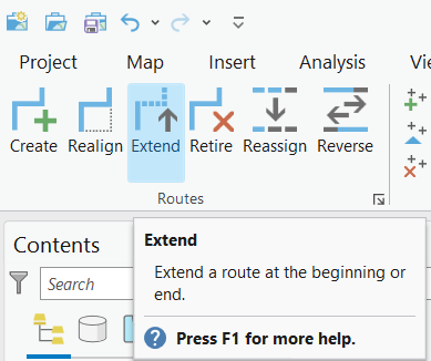

As I start to move towards testing the Location Referencing tab of the Ribbon in ArcGIS Pro 3.0.0, I'm noticing that if I mouse-over a button and Press F1 for more help, the page it goes to is often/invariably from ArcGIS Pipeline Referencing instead of from ArcGIS Roads and Highways and I am using the latter.
Sometimes I switch a page like Extend a route—ArcGIS Pro | Documentation (which has a Pipeline Referencing URL) for one like Extend a route—ArcGIS Pro | Documentation (which has a Roads and Highways URL) by replacing "location-referencing-pipelines" in the URL with "roads-highways".
Do I need to always go to the trouble of doing that or are all such pairs of pages identical?

Unfortunately, even though I have it set to Roads and Highways, when I click F1 while hovering over a button like Realign in the Routes button group of the Location Referencing ribbon tab the help page that opens in my browser is still that of Pipeline Referencing.
I think the F1 key not taking me to the correct documentation is a bug.

This is a limitation within ArcGIS Pro.  We've made the decision to remove the link to the help all together to prevent any confusion for our users moving forward.  You'll see this change reflected in Pro 3.1.
