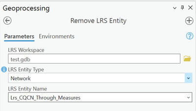

The procedure I used for my test was:
  1. Copy/paste the LRS Dataset (which has a Line Network and a Derived Line Network based on it) from an ArcGIS Enterprise 11.0 geodatabase into a new file geodatabase using ArcGIS Pro 3.1.3.  I'm mindful that this may be introducing a version incompatibility but that's something that we'll only be able to reconcile soon.
  2. Open Remove LRS Entity tool in the Geoprocessing pane
  3. Set the LRS Workspace, LRS Entity Type and choose the Derived Line Network from the LRS Entity Name pick list.

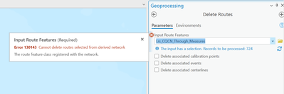

Re-reading the error message above I wondered whether I might need to try and use Delete Routes on the Derived Line Network before using Remove LRS Entity but I was blocked when I tried to do that too:
NathanEasley
The Delete Routes tool only works on non line and line networks (not derived).  I'd recommend exporting the routes in the line network to a scratch feature class, deleting all the routes in the line network (without checking any of the other options) which will also delete the derived network routes and centerline sequence records, remove the derived network via Remove LRS Entity tool, then reload the line network routes from the scratch feature class using Append Routes.
