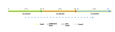

Have you modelled LRS with Line Network ? This type of network supports events that span routes on the same line as below.
There are additional considerations on modelling Line Network
  • Maintains measure across routes with discontinuities in measure and restrict change in measures downstream of the affected area.
  • Model events that span routes.
  • Route editing across routes that belong to the same line.
  • Model and maintain derived network ID and derived measures on Event records. Persisting these attributes help with reporting and quick lookup of continuous measures.

At organizations with enterprise GIS, LRS layers are consumed by multiple departments. Any LRS model changes should be discussed, planned and tested in a pilot environment. Organizational benefits need to be weighed out and adjustments may be needed. The Esri Community reach out is for ideas and research  before executing any changes.
I assume you are staff at a railroad/subway organization that has a Linear Referencing System (LRS)  developed using Roads and Highways
  • Is the LRS modelled with Line Network (this type of network supports events that span routes on the same line)?
  • If unsure, you can check using layers properties of route network > location referencing > Field Network properties:
Option 1: No Line Network
  • Review the data schema/information model requirements of  Network feature class
  • Use Create LRS and setup a pilot LRS
  • Use Create LRS Network checking the Include Fields to Support Lines parameter and map the additional fields required for an LRS line network.
  • Use Create LRS Event checking the Event Spans Routes.
  • Load sample data for routes and events to this pilot LRS and test that this configuration meets the desired capability.
Option 2: Line Network
  • Some steps may be skipped if Line Network is already configured.
  • Load sample data for  events and test that this configuration meets the desired capability.
