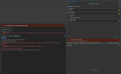

I'm posting this here because I've seen that the Prune Branch History tool can address many of these issues, but I'm seeing that an LRS-enabled geodatabase doesn't support the Prune Branch History tool's operation.  If it does, I can't seem to run the tool anyway because it errors out right away.

@Royce_Simpson Thanks for posting the error screenshot, confirming the current limitation of  Prune Branch History with LRS-enabled geodatabase. There is a pending enhancement request and I would recommend logging a Tech support case to have your organization added to this enhancement request.
Meanwhile, explore other options to make the layers performant and get ideas from the community.
  • I can think of the option to test in a lower environment where you un-version the layer. While this is neither elegant and nor recommended if you must retain the edit history, un-versioning should collapse the  archived, intermediary transactions in the geodatabase.
  • Look at moving the parcel layer to a feature dataset other than the LRS feature dataset. It opens up the option to keep the landbase feature dataset un-versioned. You can perform maintenance and tuning on this landbase feature dataset without affecting the LRS. This is a schema change, so discuss, plan and test before implementing changes.

Here's the Prune Branch History error:
