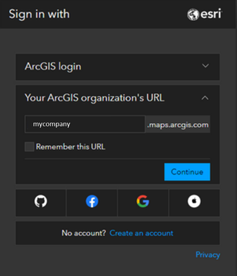

 I believe this might be because I typically log into ArcGIS online through my organization's URL: mycompany.maps.arcgis.com (as seen below):
So I finally tried to use tokenURL='https://mycompany.maps.arcgis.com/sharing/rest/generateToken', but that didn't work either:

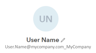

I am. Here's a snapshot of my user profile (I've edited the actual username for privacy):
But as I mentioned in my original post, I don't log in to ArcGIS online though the default portal. Instead, I use my company's organization URL. I have the feeling that that is what's causing the issues here.
LongDinh
That looks like a Azure Directory account linked to your organisation's ArcGIS Online. You should either:
  1. Use your organisation's ArcGIS Online named user administration account, or
  2. Have your ArcGIS Online named user administration account create a named user for purposes of generating tokens.
The later is generally the preferred solution as you should set up the contents/groups shared to the named user so that it has limited access to items in your organisation's ArcGIS Online
