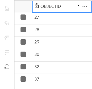

Edit: Yours truly is a big dumb dumb, and had a filter on the MapViewer instance I was using, which is also applicable to the Field Maps map that I was testing this on. So, sure enough, every map I checked, had the feature removed. But, all the data was still there, loading it into ArcPro showed that. Heck, it looks like the values I thought were bad, actually don't matter to the converter, it can handle all sorts of numerical data.
Big W for ESRI, Big L for AgLaCo.

Given that there is a DeleteFeatures REST method, it is my understanding that Update Features should not remove features, it should only change them. I updated a feature yesterday, receiving the following updateResults response:
 "updateResults":[
    "objectId":34,
    "uniqueId":34,
    "globalId":"0bdc2adb-0475-40f4-b6b1-61e11f0abacd",
    "success":true
 This response communicates that the object was successfully changed, and indeed, when I check the layer in ArcGIS Online, I can see that it was changed... by being completely removed. Notice in the following image the absence of OBJECTID 34 (It is sorted by lowest to highest number).
