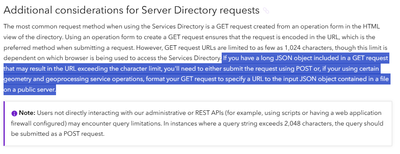

I did find this nugget which might be important:
https://developers.arcgis.com/rest/services-reference/enterprise/get-started-with-the-services-direc...
Get Request URLS have a limit of 1024 characters, I had not seen that limitation specified previously., the note suggests certain types of apps may find this limit as 2048... not sure why the difference though.

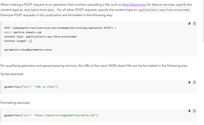

This then does say what  @JoshuaBixby I think was alluding too:
So while that parameter I suggested might help in the query strings for output it won't change the content-type the server expects, so I think Joshua was correct after all.
DavidLovesArcGIS
Thx for checking Tim! Yeah indeed in the documentation it seems for POST requests you always need to use application/x-www-form-urlencoded and can't use JSON unfortunately.
