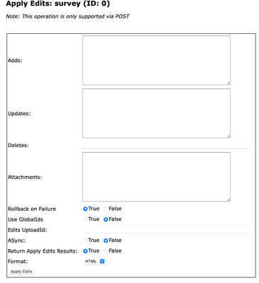

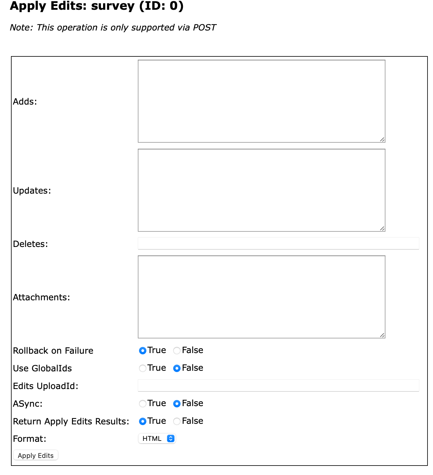

It appears to accept the token, but returns a result of the html page of the Rest Service directory for the  applyEdits URL:
I am unsure how to debug this, but have tried issuing the POST from POSTMAN as well as an online validation site, with the same results.
