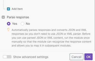

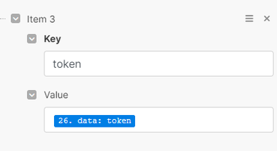

iHack
@RamunasKraujutis  I selected the Parse response (fig. 1) in the generateToken request.  It is now pulling the token into the updateFeature token field input; however, I'm getting an error for the output (fig. 2):
Data
{"error":{"code":498,"message":"Invalid token.","details":["Invalid token."]}}

iHack
I was able to resolve this issue of receiving the error code {"error":{"code":498,"message":"Invalid token.","details":["Invalid token."]}} in Make [formerly known as Integromat], which is mentioned by others in this thread; but, I had not seen a resolution for it.
Methodology:
  • Generate Token HTTP Request Module:
    • Module Configuration:
    • Added HTTP Make a Request Module to generateToken before updateFeature HTTP Make a Request Module
  • Update Features HTTP Request Module:
    • Used URL to secured feature layer
    • Set field Key to token; value to parsed token data output of the Generate Token module
The main thing that made a difference for me in generating a token that would not cause the error was to set the client parameter to refer instead of requestip; then set the refer parameter to the base URL of the feature layer that I'm updating.
