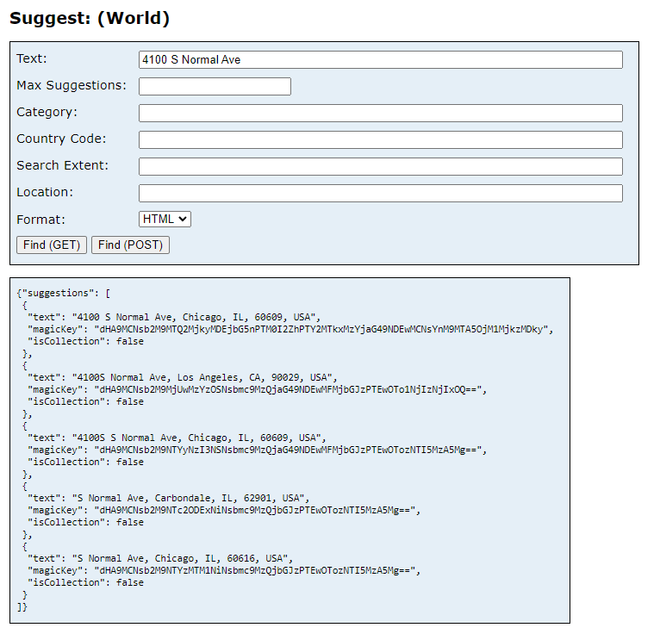

Another option would be to use the auto-complete first and send the first result:
