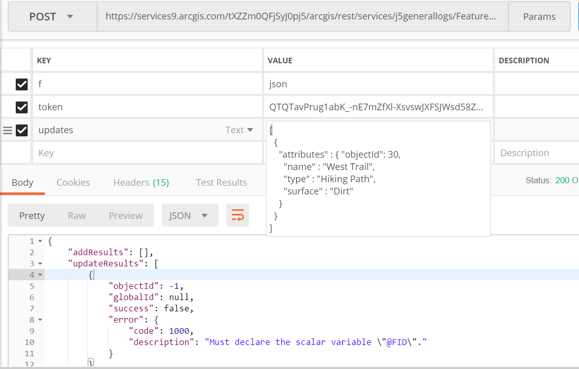

Hello Guys!
I'm trying to simply update a feature using the applyEdits utility in Feature Service and I'm getting this response every time. Below you can see a screenshot of my postman request, am I missing something?
Thanks in advance for your help!
Juan_CarlosFranco
Hi, Dario.
Could you try adding the FeatureLayer's objectIdField to your attributes instead of "objectId"? From the error message, it's probably 'FID'.
E.g.,
    "attributes": {
      "FID": 30,
      "name": "West Trail",
      "type": "Hiking Path",
      "surface": "Dirt"
