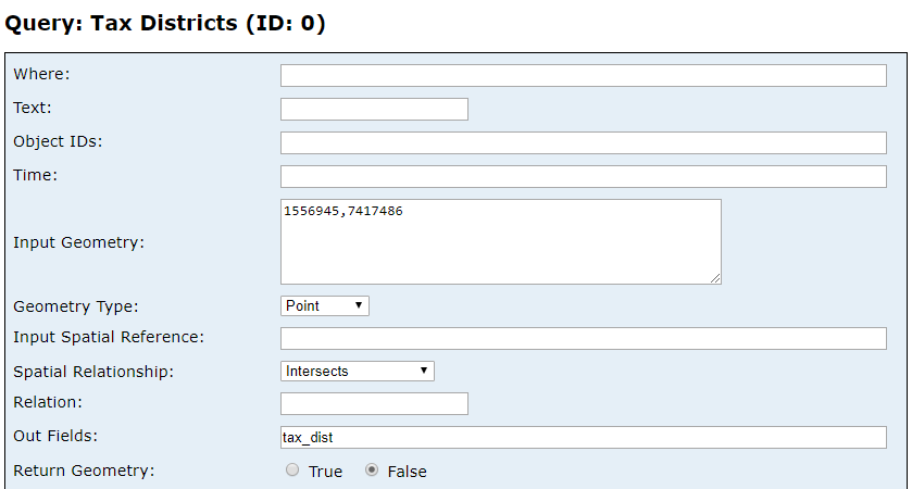

This is my first stab with the ArcGIS REST API, having just completed the  intro course yesterday.  I can get a successful return when using a single pair of xy coordinates as Input Geometry as a query to a MapService Polygon layer.  My objective is to get the tax district value for a given geocoded address: simple point in polygon.  However, I can't seem to find the proper syntax to perform the operation on multiple pairs of xy coordinates.  This is how I get a single pair to work:
I've truncateded the values for ease of reading;  can I input multiple pairs in a query?

No doubt, you have been experimenting.  I've queried using something like this for a polygon:
polygon rings
and for an extent (xmin, ymin, xmax, ymax):
xmin/max ymin/max
For a little documentation see: Query (Feature Service) and esriGeometryType Constants.  For me, it's mostly been some experimenting.
