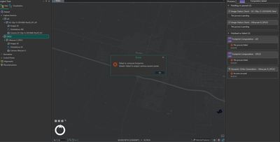

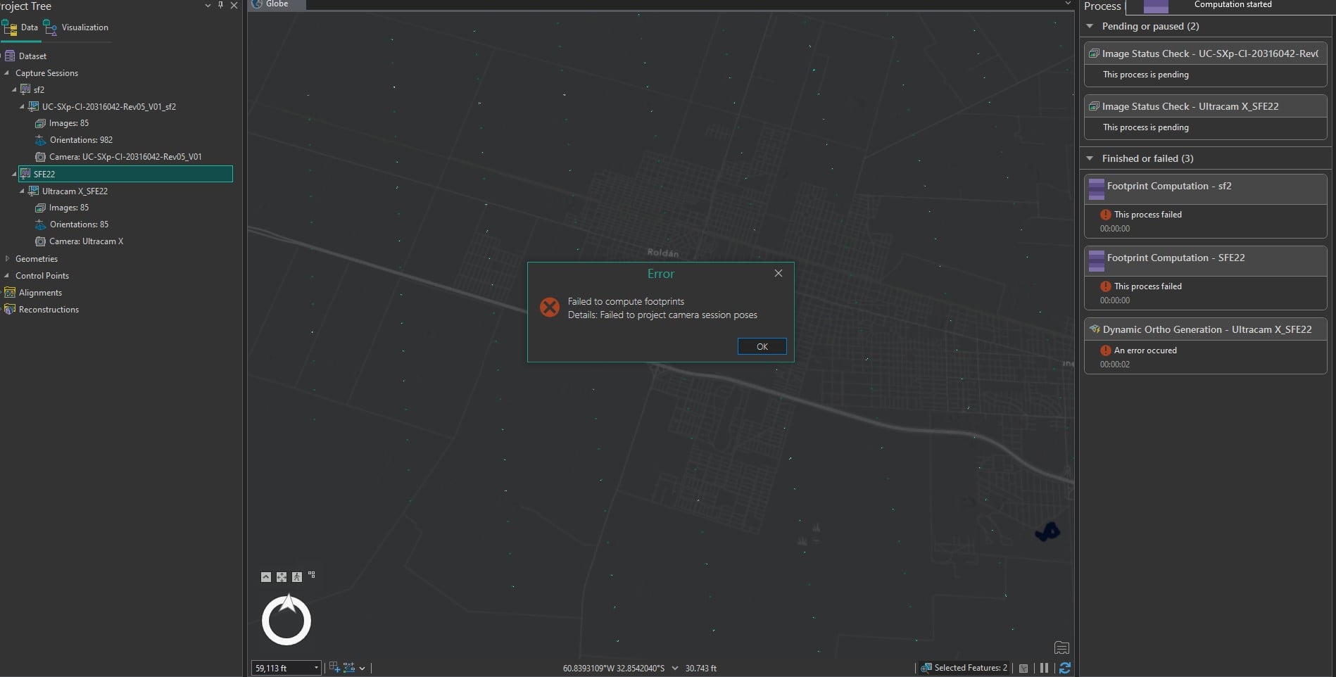

I have the error: Failed to Compute footprints.
Details: Failed to project camera session poses.
I used a Match AT Prj, if I import this file in ArcGIS Pro extension, I won't have problems but in ArcGIS Reality Studio 1.0 fail. I cannot generate the dynamic ortho.

Hello @johnpol,
Thank you for the inquiry. This error can occur if the supplementary ArcGIS Coordinate System Data is not installed.
Can you please confirm whether it has been installed on the computer you are using?
Could you also provide the horizontal and vertical coordinate systems specified?

johnpol
I don't have access to that webpage? Where I can download that file to try?
johnpol
Horizontal EPSG: 5347 and Vertical SRVN16 Argentina

johnpol
Hello Camilo
That was the problem, I needed the supplementary ArcGIS Coordinate System Data.
Best Regards
