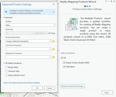

Hi @Jake
Can you screenshot the Advanced Product Settings you used?
See below an example.

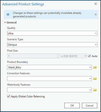

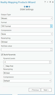

Jake
Hi @RCorcoranAdams
This is parameter that i set before generate product.
Thanks
