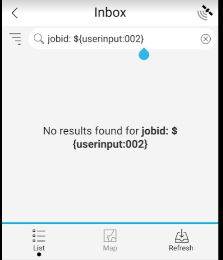

I've a custom url configured to open survey123 and apply a filter based on the quickcapture project user input.
arcgis-survey123://?itemId=4444444444444444444444444&filter=jobid: ${userinput:002}
This works fine in that it opens the correct survey123 project however the actual userinput value doesn't get applied. Instead the filter term in survey123 is literally "jobid: ${userinput:002} instead of for example "jobid: 1234"

Hi Mark,
This looks to be a bug, we are looking into this now.
Thanks for sharing.

JohnathanHasthorpe
Hi Mark - we have a fix for this in the beta builds:
https://earlyadopter.esri.com/project/version/default.html?cap=9c6a1e4687c34c7fb5c6f8f4e0bc2df3&artt...
Please test 1.12.44 if you can.
Thanks
