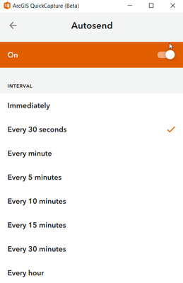

The QuickCapture mobile app has a setting for autosend:
If you enable it (and select an interval) captured features will be automatically uploaded without user interaction.
