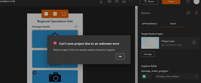

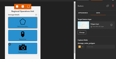

TanyaMatthews
Hi I am also having this issue and have tried following the tutorial with no resolution.
  1. In button data configuration, for capture fields it is by default set to ‘Fixed value’ for my field ‘damage_notes_polygon’
  2. I update this to button user input with the following configuration
  3. When I try to now save the app, there is an error (which is resolved by setting the field back to fixed value)
