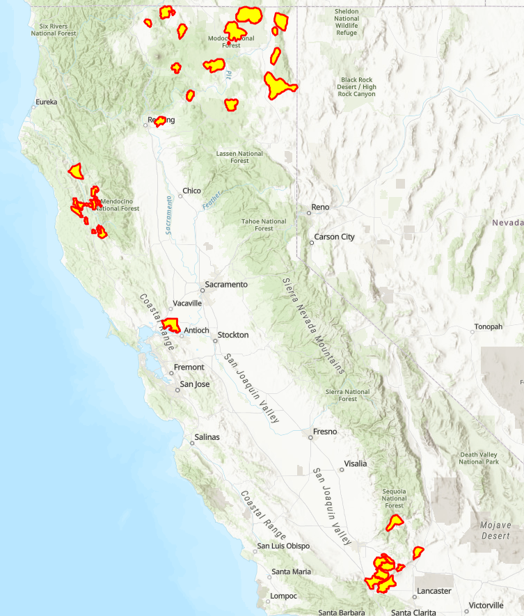

Hi Johnathan - at the conference this year, I inquired about the possibility of multiple offline areas within QuickCapture.  The problem I'm running into is that my state agency conducts aerial wildlife surveys for a given species throughout California.  These surveys are almost always in an offline environment (no cell or wifi connection).  We would like to have an offline basemap available to users which will  depict not only a basemap, but survey polygons and transects on the map.  Because the surveys occur over such a large geographic area resulting in massive offline map packages - I'm currently having to replicate the QuickCapture app (using Save As) into multiple QuickCapture apps that are specific to a geographic area - strictly to accommodate the offline map package limitations.  So this is mostly a plug to request this functionality and to see if there might be some sort of an update on whether this is on the radar?
