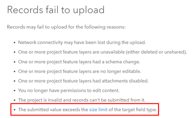

A quick cursory search shows that data that is being sent is too big for the field holding it? How can I fix this?
SamuelCanas
Esri Alum
Hello @GIS412, as you said this error occurs when the submitted value exceeds the size limit of the target field type.

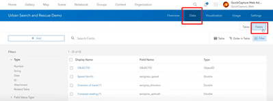

Maybe this can help you to fix this. You can sign up in ArcGIS Online, go to your ArcGIS QuickCapture App and in "Data" select the "Fields" option.

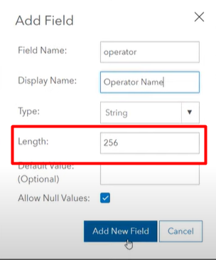

When you add a new field there is a maximum length option, try to create one with 1000 max length (or see if you can edit the one you are trying to use to send the records). Maybe this can fix the problem.
