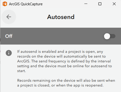

This can be achieved using the app’s Autosend setting. If Autosend is enabled, QuickCapture will attempt to upload records at a defined interval whenever the app is online.
To avoid this:
  • Disable Autosend in the app settings
  • Records will remain on the device until the user explicitly sends them (from the map page), for example once they are back on a stable Wi‑Fi connection
You should also note that Auto Send can be set using an organisational setting, meaning it is possible to enforce the setting for all users in your organisation.
To avoid this:
