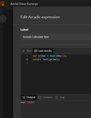

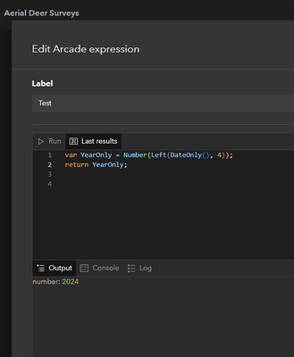

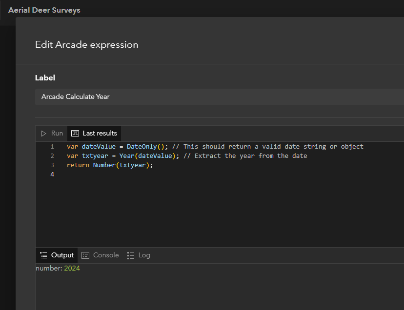

We're currently working on a project where we're trying to calculate the current year into our field when a button is pushed using Arcade Expressions.
We have tested numerous ways of writing the expression and all return an empty result even though the Arcade expression editor shows the return to be correct.
We have tried to return this as both a Number() and Text() to two respective small int and text fields with no luck.

@Amanda__Huber - There was a bug in the mobile application. In the december release (1.21) we will have a fix for Text(Year(Now())) not returning a string version of the date.
This will resolve the issue that you were seeing.

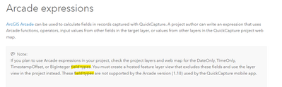

DateOnly() is supported in Arcade 1.24 onward.
https://developers.arcgis.com/arcade/function-reference/date_functions/#year
QuickCapture uses 1.18
https://doc.arcgis.com/en/quickcapture/help/arcade-expressions.htm
Do not expect Arcade to work universally across the platform. That may be the goal but newer stuff we use in core profiles like map popups takes longer to reach other parts of the platform.

Thanks for the response! To clarify, the documentation for Arcade Expressions in QuickCapture refers to DateOnly Fields not the DateOnly() function. That being said I now understand where you're seeing these version differences, sounds like the documentation is what is confusing.
It's still not clear why Date() and Year(Now()) are causing issues when submitting the record.
Other expressions in the project are working fine and no issues which leads us to thinking it's just a QuickCapture issue with dates.

https://developers.arcgis.com/arcade/function-reference/date_functions/#dateonly
The function DateOnly() is since version 1.24 and QuickCapture states it's on 1.18. So it would be both the fields and the function.
