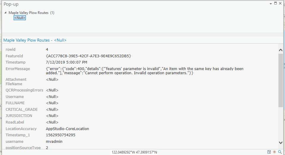

JohnathanHasthorpe
Hi Cathy
The issue is caused by an incorrect edit made to the project using the JSON editor:
"attributes": {
                           "Username": null,
                           "FULLNAME": null,
                           "CRITICAL_GRADE": null,
                           "JURISDICTION": null,
                           "RoadLabel": null,
                           "LocationAccuracy": "AppStudio-CoreLocation",
                           "Timestamp": 1562950845295,
                           "username": "mvadmin",
                           "positionSourceType": 2,
                           "pluginName": "AppStudio-CoreLocation",
                           "startTime": 1562950845295,
                           "endTime": 1562951119295
The username field appears twice. Removing the duplicate and saving the project will fix the issue.

City_of_Maple_ValleyGIS
Hi Ismael,
Thanks for the quick reply. I have installed the ArcPro plug-in and have looked at the data in ArcPro and all of the polylines that I have captured with the app on my phone have the same error message
{"error":{"code":400,"details":["'features' parameter is invalid","An item with the same key has already been added."],"message":"Cannot perform operation. Invalid operation parameters."}}
although I am not sure what this error means particularly or how to prevent it from happening when I go out and test the app I built by collecting additional data. I have sent the qcr  file to the e-mail address you put in your reply. I appreciate any help you and your team can give me in getting my QuickCapture app to sync.
