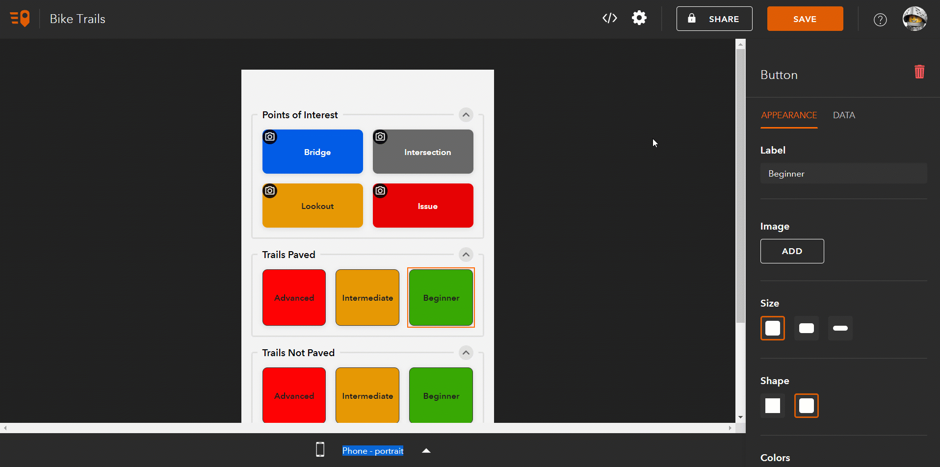

Yes. You can change the distanceThreshold property in the project through the JSON editor as shown below. The distanceThreshold is defined as the minimum distance that must exist between two consecutive vertices in a polyline or polygon. It is always expressed in meters. You can use an integer or decimal value. If you use a decimal value, enter a . as a decimal separator.  Do NOT use a comma as the decimal separator.
If the text in the animation below is too small, you can click on the animation to enlarge it.
