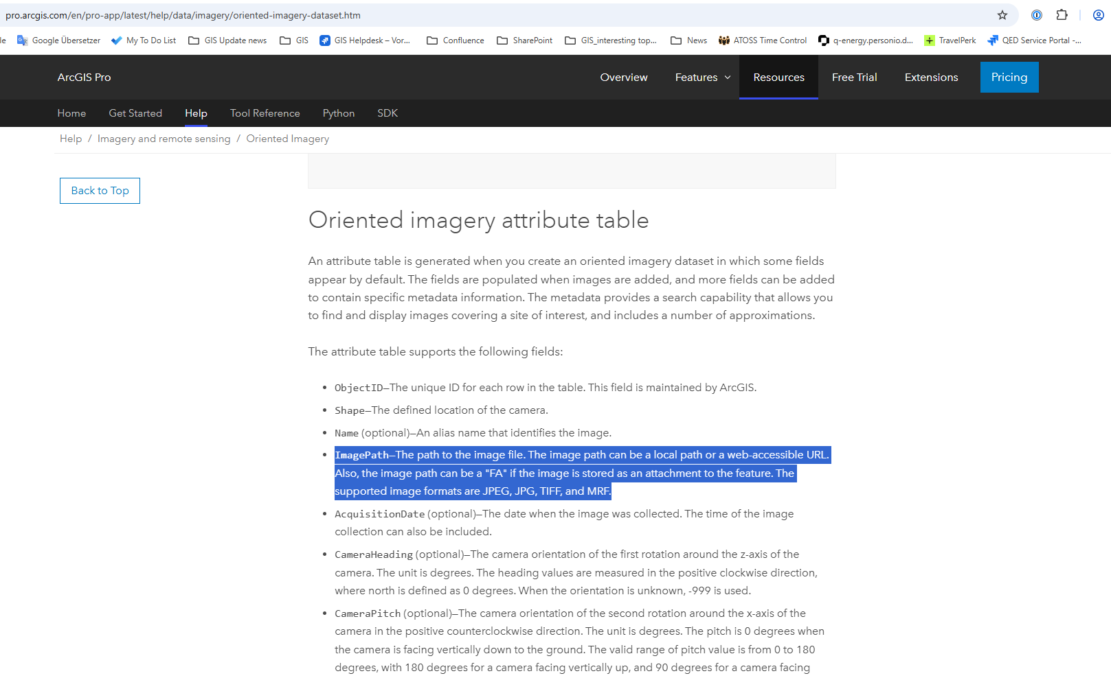

We use a hosted Oriented Imagery layer in Quick Capture. As we collect many photos and Data Store have a limited capacity, we want to store the attachments (images) somewhere else but not on the feature layer. In the QC, I therefore changed the Image Path from FA to a URL of a non-hosted layer (https://....../portal/home/item.html?id=0155480098db48af90996190e615154a. ). However, it doesn't seem to work.
The result is that I can see the attachment in my OI layer once I have taken photos, but I can't see any attachments in the non-hosted layer.
Does anyone know how we can save the attachments to a server or folder without using the data store?

@MR-QE QuickCapture only supports photo uploads through the feature attachment workflow. The ImagePath field is intended to inform oriented imagery clients where the imagery is stored — it does not tell QuickCapture where to store them.
