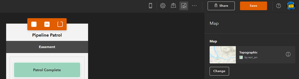

  3. In your QuickCapture project settings, go to Map Settings and set this web map as the project map.
