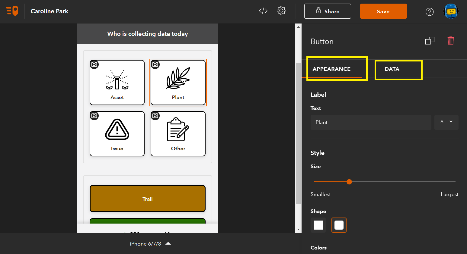

The button labels that show by default in QuickCapture designer are based on your feature layer default renderer. You can create new buttons in QuickCapture designer and decide what values should be written in the editable fields you have in your feature layer. You can also control what exact label (and or image) you want to show in a button.
If you want a button to populate a value in your record, but you do not have a field in the feature layer for it, then simply add the field into the feature layer and then open your project in QuickCapture designer again.  You cannot add new fields into a feature layer from designer. That is something you need to do from ArcGIS.com, ArcGIS Pro or another tool.
The label of a button, and the data that goes into the feature's attributes are two totally different things. You control the label of your button from the Appearance tab. The values that get written into fields are controlled through the Data tab.

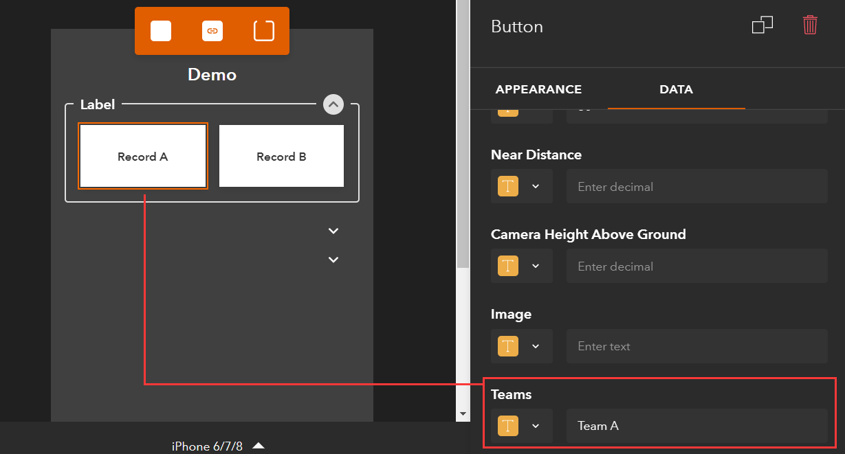

The label of a button is simply the visual text display. You can have as many buttons as you want in a QuickCapture project, and each button simply represents a record to be captured.
If you want to add a specific attribute to this record/button in addition, you can add a data field for the button's target feature layer from ArcGIS Online, for example, add a new string type data field called "Teams". Come back to QuickCapture designer, refresh your project (remember to save the project before reload), click the button (e.g. Record A) in project preview, in the DATA tab, you will see this new field shows up for you to define a value. In fact, because the data field is a string type, you can enter any text for it, team a, record a, record b, etc. When the button is pressed from the mobile app, the preconfigured value will be captured and sent back to your feature layer as the value of this 'Teams' data field. Your dispatchers will look up the data attributes for this new record and they will see the value "Team A" in there.
