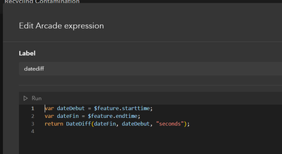

JohnathanHasthorpe
This is working in QuickCapture 1.20

JohnathanHasthorpe
