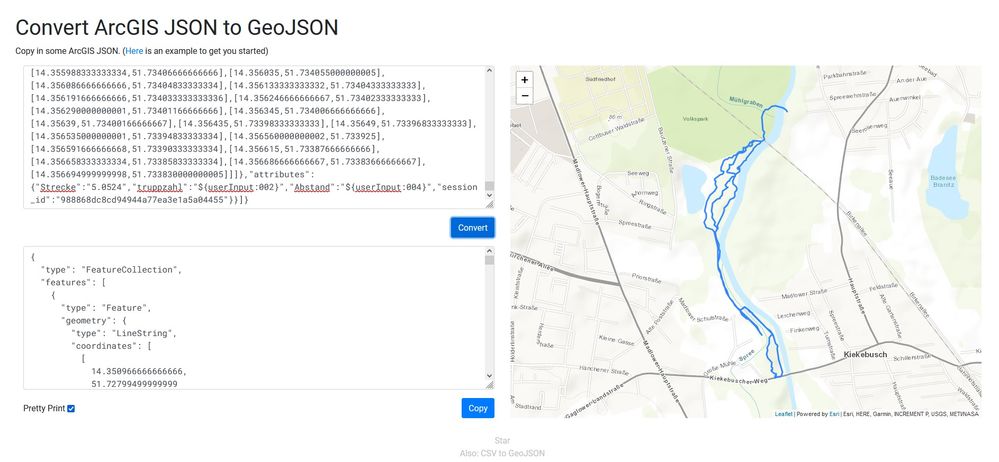

OK, I found a way to save at least the data.
rename the qcr file as zip and unzip it, then copy from the SQlite database the table "main.Features" from the column "Feature" the json and extend it with {"features":[ at the start and ]} at the end .... for testing you can use https://arcgisjson.togeojson.com/
and export a geojson right away, because the Attribute are unfortunately not taken over in the standard processing.
and here you can see the possible error.
the user has for whatever reason not entered anything at the ${userInput:002} as well as ${userInput:004}, although this is mandatory and so of course this text could not be stored in a numeric field.
