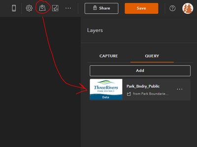

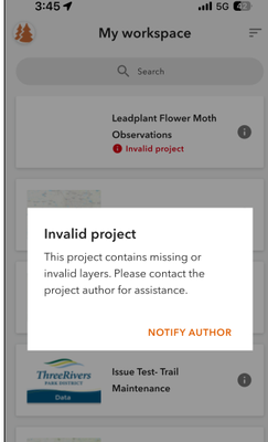

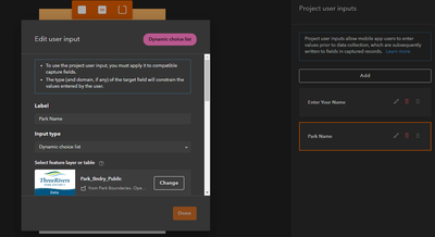

We appear to have found an issue with dynamic choice lists that use data coming from ArcGIS Enterprise. When opening a project using enterprise data for a dynamic choice list we get the error "Invalid project". When switching to AGOL hosted we don't see any issues.
 Is Enterprise data supported for this functionality or only ArcGIS Online Hosted data?

JohnathanHasthorpe
Hi Amanda
The issue is that the online item used in the dynamic query is referncing a ArcGIS Server Service. This is not supported in ArcGIS QuickCapture. We will add a check to the designer to make sure such layers can't be selected.
