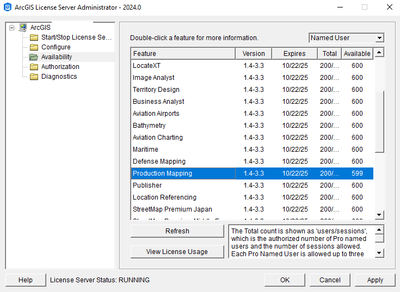

- Installed License Manager and authorized for Named User. After I authorized, I made sure the features are available.

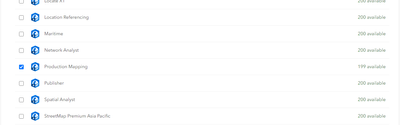

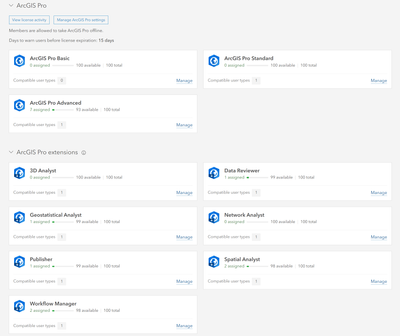

- I created a new member called GeoffHodgson with User type = Creator and Role = Administrator. For Manage add-on licenses for Geoff Hodgson, under ArcGIS Pro I enable ArcGIS Pro Advanced and under Extensions I enable Production Mapping.

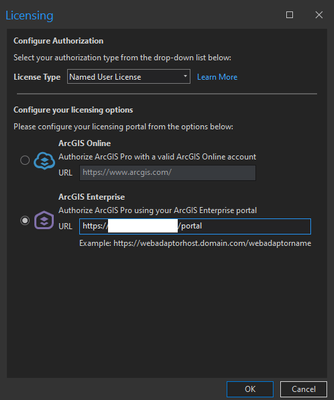

- On my desktop machine, I launch ArcGIS Pro and for Licensing I set my License Type to Named User License and configure my licensing option to use ArcGIS Enterprise and I connect as GeoffHodgson

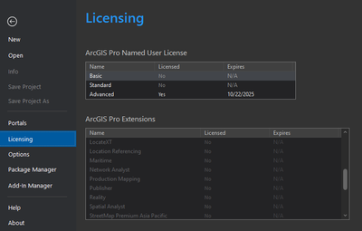

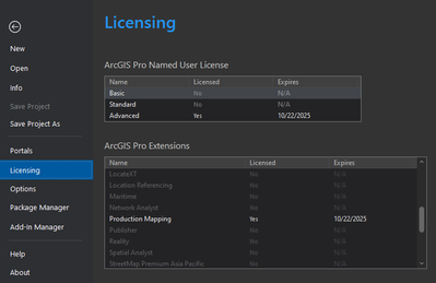

- I exit ArcGIS Pro and re-launch ArcGIS Pro and this is what I see for Licensing

- In portal, for Manage add-on licenses for Geoff Hodgson, under ArcGIS Pro and under Extensions I disable Production Mapping
- I launch ArcGIS Pro and this is what I see for Licensing
