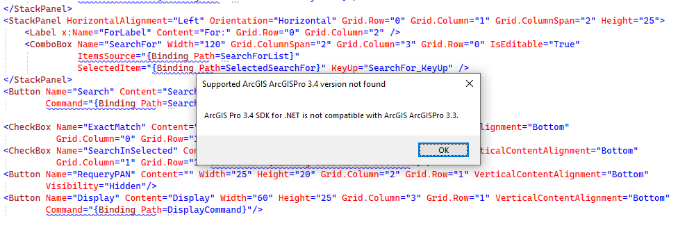

Working on a project that was stubbed out by a third party and I'm now supposed to add additional functionality. Noticed in one of the dockpanes, lots of errors where being thrown (despite working fine when run in debug mode) mostly of the "No data context found" and "The specified value cannot be assigned" variety.
I decided I'd give making a test dockpane a shot and see if I could get one working without errors before trying to troubleshoot this one, but got a compatibility error when I tried to create it, as shown below.
I currently have ArcGIS Pro SDK for .NET 3.4.0.55405 installed. Any ideas why I can't create a new dockpane? Like I said, despite all the errors in the XAML, everything loads fine and runs properly.

Are you trying to run ArcGIS Pro SDK 3.4.x on ArcGIS Pro 3.3?
Your SDK version must be less or equal ArcGIS Pro version. You can run code compiled with ArcGIS Pro SDK 3.3 on ArcGIS Pro 3.4, but not otherwise.
