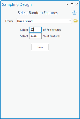

I have built an add-in to select features from a layer.
There are two TextBoxes on the panel, MultiStageCountValue, which signifies the number of features to be selected, and MultistagePercentageValue, which signifies the percentage of features to be selected. If the user types in the number of features, the code-behind will calculate the percentage of features, updating the MultistagePercentageValue textbox. If the user types in a value for the percentage of features, the code-behind will update the value for the MultiStageCountValue textbox. It also recalculates the actual percentage, since I only allow for integers to be typed into either field (for example, 33% of 76 features is 25 features, which is actually 32.89% of the features)

In my testing, the MultistageCount value gets updated correctly if I type in the MultiStageCountValue textbox or when I type in the MultistagePercentageValue TextBox and then click in the MultiStageCountValue textbox.
However, if I type in the MultistagePercentageValue TextBox and tab out of the text box, while the MultiStageCountValue textbox will get updated, the MultistageCount value does not get updated and the query uses the previous value.
Why doesn't MultistageCount get updated when the focus is lost by tabbing out of the textbox versus clicking outside it?

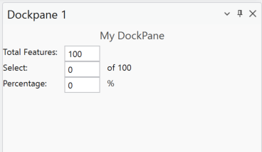

Have you looked into using WPF Notifications to allow the text box UI to update?
I have attached a simple dockpane sample with text boxes to illustrate this.
You set the binding in the xaml for text boxes like this:
      <TextBox Grid.Row="1" Grid.Column="1" Text="{Binding SelectionCount}" .../>

Thanks for your reply. I'll dig into this.
Please note that you're using a beta version in your testing. When I opened it, it couldn't run since it was targeting ArcGIS Pro 3.5
UmaHarano
Good catch. I updated the zip to point to Pro 3.4.
