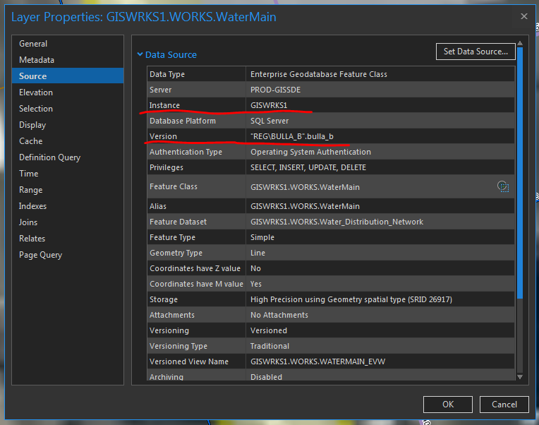

What I'm realizing is that I don't need to Subscribe to EVERY layer in every map.  I only need to subscribe to the layers from a particular server, or even more specifically, those that are Versioned.  Any tips on determining if the current FeatureLayer is versioned??  It doesn't appear to be in the FeatureClassDefinition.  Where should I be looking for this??
