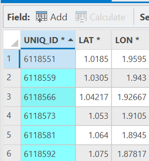

I have a table that I am loading in from an enterprise oracle database, as a Feature Layer. Table view of feature layerTable view of feature layer

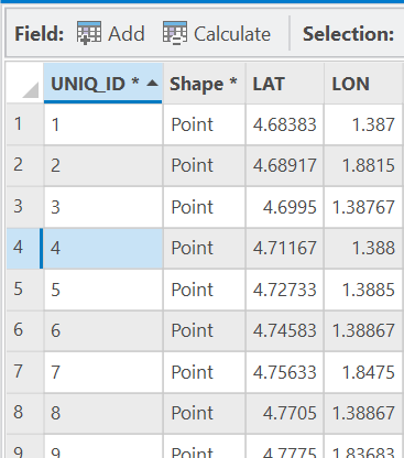

But after I apply the CopyFeature Tool to the table to create a local version  of the table, the UNIQ_ID field (type OBJECTID) is overwritten to new values.
Table view of copied feature layerTable view of copied feature layer
Is there some flag or step I am missing to prevent the values from being changed like this?

I believe this is expected behavior. ObjectID columns are columns that are managed by Esri and we typically don't have much control over them. It's typically not recommended to use them for reasons like this.
With that being said, the Copy tool (not Copy Features) should maintain the ObjectIDs.

TrentSchweitzer
Thank you for the suggestion of using the Copy tool. Doing this at least made a stand alone copy of the Feature Class. I was then able to use the Make XY Event Layer tool to make the stand alone table a feature layer. This preserved the ObjectID values.
