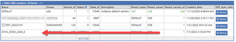

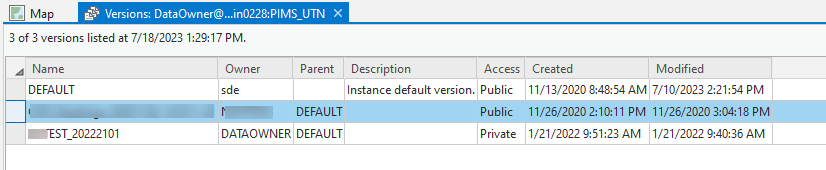

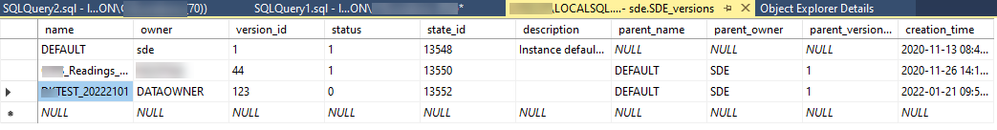

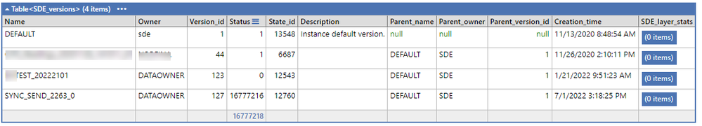

checking the versions on the geodatabase I found: the records in the database are not the same that ArcGIS Pro 2.9 shows:
Cristian_Galindo
when I delete the row that is not shown by ArcGIS Pro, then my snippets and my code work without issue. but then a nice - important too - question came to my mind, should I do that in production?

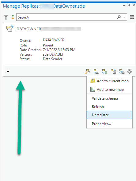

After reading a little bit I found the invisible version belongs to a replica of the geodatabase:
https://support.esri.com/en-us/knowledge-base/faq-what-are-the-syncsend-and-syncreceive-versions-in-...
https://pro.arcgis.com/en/pro-app/latest/help/data/geodatabases/overview/synchronization-and-version...
I confirm that in the dialog Manage replicas:
I unregister the the replica, and the row was deleted:
Now the script and the add-in are working
