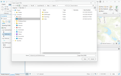

You are correct as SaveItemDialog doesn't validate the path at all.   I guess the designers of SaveItemDialog allowed for invalid paths to be entered assuming the caller would verify the validity.  I tried this in ArcGIS Pro trying to save a layer by entering a path that doesn't exist:

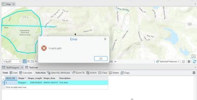

After i clicked save i get this message in Pro:
i guess it's conceivable that the calling business logic could attempt to create the path if it doesn't exist.
However, in ArcGIS Pro after the error is displayed, the caller immediately pops up the SaveItemDialog again with the 'bad path entry' using the bad path as the initial location:

I have a custom Item with a .gmcx extension, and I have created a BrowseProjectFilter to limit
the browsing to files with .gmcx extensions.
The issue I would like to fix if possible is that the user can type into the Name textbox, enter a
path using a directory that doesn't exist and yet the Save button is available and FilePath returned
is using a non-existant directory.
See the attached image as an example. The user can enter c:\directoryThatDoesNotExist\newgmcx and
clicking the Save button returns a dlg.FilePath of c:\directoryThatDoesNotExist\newgmcx.gmcx
Is there a way to have the dialog validate that everything left of newgmcx actually exists before
saveFile == true?
StevenCorpus
Thanks for verifying this for me. I have made workarounds in my code. I just wanted to be sure that this was necessary.
