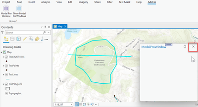

I tested your code snippet and it works fine.  I don't understand what you mean with "ShowDialog() is not blocking".  What version of Pro are you using and how do you close the Pro Window?    Try using the 'X' on the top right of the window to close it.

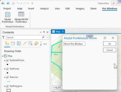

Not sure what your code is doing, but i attached a project with two Modal ProWindows.  One is WinForms based and one is Mvvm based.  Please build and run this project and see if this satisfies your needs.
Here is one of these 'modal' Pro Windows, and no user input for ArcGIS Pro is accepted until you close the Pro Window.
