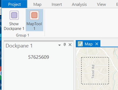

I created a new AddIn project ProAppModule1, then added two items: a Dockpane and a MapTool.
I added code to the OnSketchCompleteAsync in MapTool1.cs using the id from the daml file (ProAppModule1_Dockpane1):
protected override Task<bool> OnSketchCompleteAsync(Geometry geometry)
    // added this code:
    var dockPaneID = "ProAppModule1_Dockpane1";
    var paneVm = FrameworkApplication.DockPaneManager.Find(dockPaneID)
        as Dockpane1ViewModel;
    if (paneVm != null)
        paneVm.Heading = Environment.TickCount.ToString();
    return base.OnSketchCompleteAsync(geometry);
I ran it, clicked the Maptool1 button, then clicked on the map twice:
Note that I made no changes to the Module1.cs or Dockpane1ViewModel.cs.
The only change was to MapTool1.cs.

JeffSauder
Thanks Kirk, that worked.  The sample that I was looking at didn't have it defined that way, it was using the definition in Module1.  This was much simpler.  I appreciate you looking at this, this will get me going on to the next challenge in this app.
